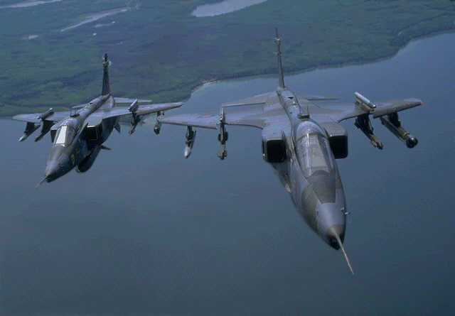

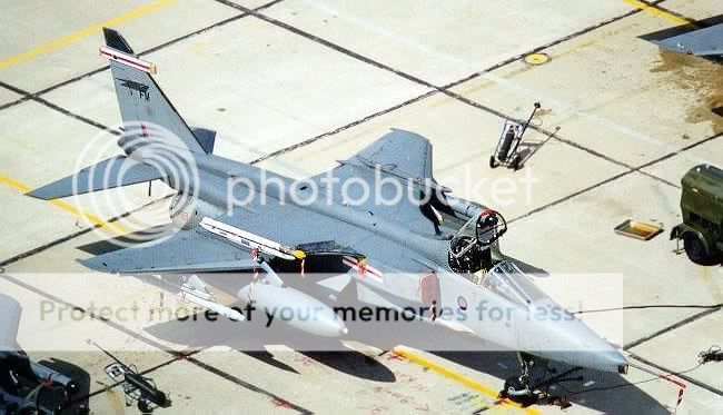

Про ракеты над крылом:
http://www.fas.org/man/dod-101/sys/ac/row/jaguar-solo_1024.jpg
http://img65.photobucket.com/albums/v197/Amraam/jaguar_5.jpg http://img65.photobucket.com/albums/v197/Amraam/jaguar.gif
BTW, Jaguar was not the first plane to be able to carry weapons over its wings: Lightnings F.Mk.53s, sold to Saudi Arabia and Kuwait in late '60s could carry both ferry tanks (of course, these couldn't be jettisoned), Matra SNEG 68mm rocket launchers and JL.100 combined rocket launchers/fuel tanks over their wings.
This was first done by the IAF'S ASTE(test establishment which does iaf specific modifications) and the design was then given over to HAL.Subsequently,the design was *licenced* to Bae and the RAF followed suit.They did pay royalty for quite a few years..or might be still doing so.

здесь ВУ находятся под крылом. Старт - над крылом. Газодинамическая устойчивость для самолета с большими возможными УА должна быть высокой. Остается только загрязнение фонаря..
но, наверно, пуск явление не столь частое. чтоб оно сильно влияло?
